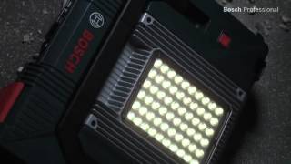

GLI PortaLED 136 Professional BOSCH GLI PortaLED
